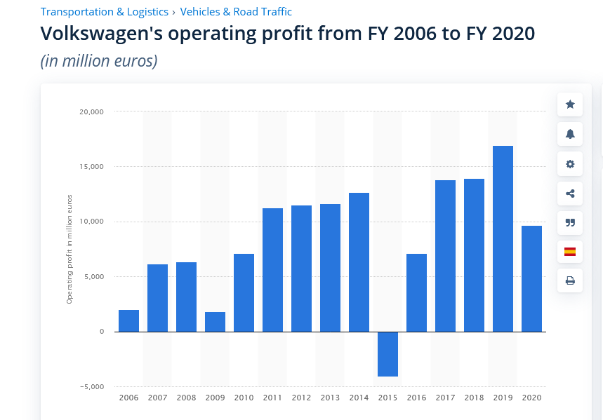

Mmm...te cam contrazic (rau) si la faza cu facutul banilor cu nemiluita - piata auto a fost afectata grav de covid si VAG Group deodata cu ea :
Screenshot-2021-10-03-at-09-13-52-Operat
Volkswagen AG annual net income for 2018 was $13.968B, a 9.09% increase from 2017.
Volkswagen AG annual net income for 2019 was $14.948B, a 7.01% increase from 2018.
Volkswagen AG annual net income for 2020 was $9.52B, a 36.31% decline from 2019.
Volkswagen AG net income for the quarter ending June 30, 2021 was $5.856B, a 430.94% decline year-over-year.
Deci VAG a facut bani "cu nemiluita" in 2019....in 2020 (primul si cel mai dur pt ei an covid) a avut aproape 36.3% scadere fata de 2019,iar pe anul asta se preconizeaza o cifra apropiata de 2020.daca nu si mai mica.
Treaba merge,dar nu cum mergea pre-pandemic.Iar aia cu "cele mai mari profituri"...ehe,s-au dus vremurile alea.Asa ca si curiozitate am un prieten care si-a luat un Q7 nou in 2020 si i-au acordat reducere de peste 20k euro - am vazut contractul nu vorbesc povesti - scria reducere speciala pt 2020 sau asa ceva - masina de putin peste 100k dupa optiuni a ajuns sa dea pe ea 77k - asta ca sa intelegi foamea de clienti pe care o are VAG Group si faptul ca treaba nu sta deloc pe roze.

The German automaker saw first-half operating profit before special items hit 11.4 billion euros ($13.5 billion), exceeding pre-pandemic levels on the back of increased demand for premium cars in Europe and the Americas, while electric vehicle deliveries almost tripled.
As a result, Volkswagen upped its profit margin target for the second time in three months. The company now expects an operating return on sales of between 6% and 7.5%, having previously projected 5.5% to 7%.
https://www.cnbc.com/2021/07/29/volkswagen-earnings-q2-2021.html
Ce am pus eu si ce ai pus tu sunt date care se bat cap in cap.Nu stiu cine minte si cine nu,daca mint aia mint si eu.
Nu vreau sa zic ca aia vorbesc prostii dar 11.4 miliarde pe jumate de an e....nemaiauzit.In fine,nu mai insist.
